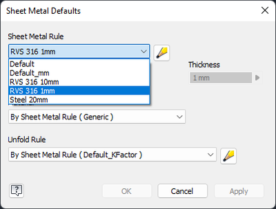

HI,
I am looking for the code that is related to the sheet metal rule.
Basically when the rules is run the msg box like the below will come up.

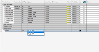

What you can do is make a new user parameter in the default Sheet metal template. In the user parameters you add a multi value parameter with all the styles that you are using. It is importent that all the styles in the multi value parameter the text is equal to the Sheet Metal styles.
After that you can add this text in a iLogic rule:
Material1 = InputListBox("Prompt", MultiValue.List("Material"), "Test", Title := "Title", ListName := "List")
SheetMetal.SetActiveStyle(Material1)
InventorVb.UpdateWhenDone = True

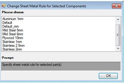

didin.suryadi6JREK
Hi
Thank you for the reply.
That should work when we create the new sheet metal.
What am looking for is the i logic for old part sheet metal.
So I just want to change the sheet metal rule on the existing part.
Rgds
