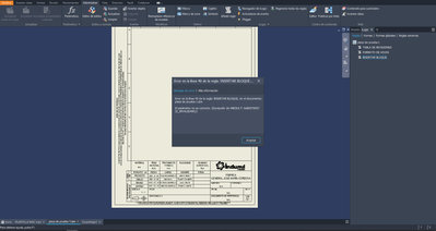

Miguel.CarvajalS34Q6
something happens on line 40; It alerts me that the parameter is not correct, the truth is I don't understand this arrangement very much, that's why I haven't been able to intervene.
Message 10 of 15
Andrii_Humeniuk
I have done the tests and I assure you, the code works perfectly. I suspect the problem is that you are using non-standard sheet formats and lines 32-36 cannot define the sheet format. I've added line 37 which will notify you of an error if the active sheet's format is not standard.

Message 11 of 15
OK, it is true that I have different sizes than the standard ones. I have a code that allows me to adjust the sizes for quick selection of formats.
That detail will be what causes the problem when running the code.
Message 12 of 15
Andrii_Humeniuk
Unfortunately on your screenshot I see information about A4 format, so I made a selector by the name of the border ("formato_a4") lines 32-36:
The code provides a very good solution, but I think that working with custom formats generates problems, it does not work because the code recognizes standard formats. For now I will work manually until I can solve the problems with the formats

Message 15 of 15
Andrii_Humeniuk
Hello @Miguel.CarvajalS34Q6 . I noticed that your borders have a name without a bottom line (example "FORMATO A4"). So I made changes to the border names and the code works perfectly for your situation.

 Make sure your borders are spelled correctly in lines 32-36 and you'll be fine 🙂
