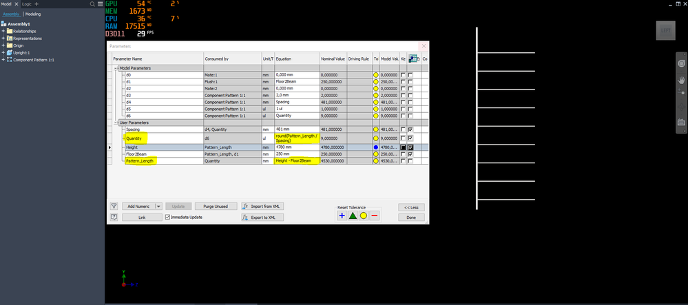

Hi Everyone,
Apologies for the Paint drawing but was in a hurry to post this question.
Does anyone know if it is possible to control your pattern with a iLogic rule?
The goal here is to have the amount that is being patterned automatically update as the length of Part A (Black Vertical Square) increases. Part B (Red Horizontal Square) is the component that is being patterned.
Currently it all is being control through parameters and a form.
The height from the ground to the bottom of Part A is controlled with a parameter, and currently the Spacing & Quantity of the pattern is also being controlled by Parameters and a form.
So for example:
If Part A is 1000mm in length, the quantity being patterned for Part B should be 2.
If Part A changes to 2000mm, the quantity being patterned for Part B should update to 4.
I'm sure there is a very simple solution that I just keep missing.
Thanks in advance for any assistance
740 Views
You can actually round your equation, so it adds more instances in a pattern based on length.
You can take a look at this attached part for the equations.
note, Inventor understands round(eq), ceil(eq), floor(eq) depending on whether you want to round up or down or just follow the rounding rules.
I'll just post this screenshot of my model as well as the parameters for inspiration. d8 is my number of instances of part b

Hi @Anonymous ,
Thanks for that quick response, the solution you gave me worked very well.
I should have mentioned that this pattern is in an Assembly, but still works fine.
Screenshot below of the quick test I didnt now.
In your note, you mentioned Inventor understands "round(eq), ceil(eq), floor(eq) depending on whether you want to round up or down or just follow the rounding rules."... do you perhaps have a link to where I can see what all those key words mean or do, and if there are even more of these handy tricks 😁
Thanks again
Hi again.
round(equation) rounds to the nearest whole number.
ceil(equation) rounds to the next higher number - eg. 3.22 would round to 4.
floor(equation rounds to the next lower number - wg. 5.88 would round to 5.
