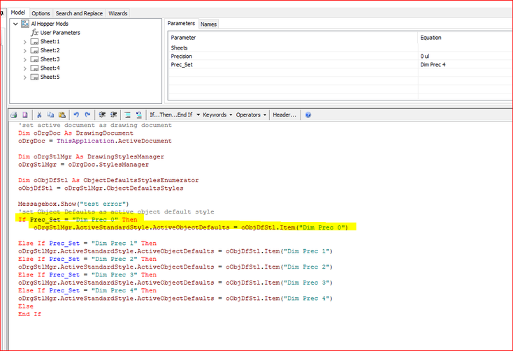

Hi all,
After some help/feedback on below coding issue i have been having. Seems to have only become an issue since upgrading to Inventor 2020 (worked fine in previous versions).
Intention of code is to select a drawing style from set selection and applying that to all sheets. (changing decimal places of dimensions is only real parameter being changed at moment).
I have a code which works to change all of the "visible" dimensions. This one is to change the style itself for all future dimensions.
My coding knowledge is fairly minimal, have pieced this code together from various forums.
Error seems to begin at highlighted line below:
Thanks in advance for any help!

marcin_otręba
try:
Dim drw As DrawingDocument = ThisDoc.Document
drw.StylesManager.ActiveStandardStyle.ActiveObjectDefaults.LinearDimensionStyle= drw.StylesManager.Styles.Item("Default - Method 2a (ISO)")
drw.StylesManager.ActiveStandardStyle.ActiveObjectDefaults - will change whole style not dimmension style

Thanks for feedback.
However neither of these 2-options appears to work.
