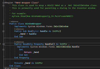

dgreatice
Hi, try this.
base on this default hWnd Wrapper Class
Please use the ACCEPT AS SOLUTION or KUDOS button if my Idea helped you to solve the problem.

Maxim-CADman77
@dgreatice
But how SetParent Method looks like?
Please vote for Inventor-Idea Text Search within Option Names
