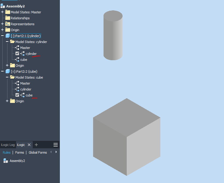

I'll be a little more specific.
I would like to select one of the ipt states from a combo box.
Insert the selected state into the assembly.
I practice programming in visual studio 2019, but I can't find anything about the states that would be in C #.
I would like to ask for an example of a C # language for state control
Inventor 2022 api help example that's not what I want VB.NET:

Michael.Navara
I don't know if it is what you are looking for, but here is rewritten example to C#. I keep original code as comments.
The API object model  is the same for VBA, VB.NET (iLogic) and C#. Differences are only in language syntax.

penzes_ferenc
Thank's your help michael.navara.
I am learning how to program Inventor and I'm looking at Inventor / Help / Api.I cannot find many programming examples of this new state.
First, I want to learn how to create a state in ipt. For example, I want to create a cylinder and a cube. Then create separate states for them.
And I want to put the cube or the cylinder in the assembly.
I don't know how I could get started.
I would ask for help in this. With an example or a website link ..
