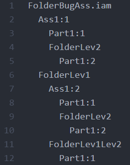

This is how my algorithm works: for every occurence I get the linked BrowserNode, I check recursively if parents are BrowserFolders and if yes I store them in my structure.
If folders belong to the top assembly everything is ok.
If folders are nested in other assemblies my algorithm doesn't work.
I've attached an assembly which structure (considering folders) is the image on the right but what I get is the one on the left:
Folder named FolderLev2 is missing.

To get the proper structure I should work directly on the ModelBrowserPane (or adopt a mixed solution) because the BrowserNodes property (that returns a collection of the top level BrowserNode objects contained under this node) works.

YuhanZhang
This seems an Inventor API bug, I logged this, thanks for reporting it.
