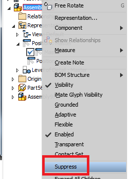

Hello Sir,
I am trying to make vessel in Autodesk Inventor using iLogic but i get some trouble to suppress component.
When i suppress component inventor make LOD. I dont understand why they make LOD.
Can you please guide me further ?? or give me any other solution to suppress parts.
Dhaval

In one assembly, you could suppress component by context menu-Suppress command or from iLogic-suppress.
The suppress action will create LOD.
If you want to know more about LOD, you could find the help content of the LOD
http://help.autodesk.com/view/INVNTOR/2017/ENU/?guid=GUID-BB22DDCB-F370-4BF0-B438-EC1D0E91D49E
You could use Design View instead of LOD in your assembly. Select one component, right click, visibility. Uncheck the visibility will hide the component, and you could switch between different Design View for different intent.

You must Create a LOD called  iLogic to be able to suppress parts usig iLogic rules.

If i choose visibility option then part will be shown bill of materil and for the same i have to mannualy correct as off from BOM.

If you are in R2017, you could get the correct component quantity in drawing Partlist by filter with Assembly Design View->select "Limit QTY to visible components only"

If you're not using inventor 2017 then there is a other way.
I've been struggling with the LOD for a long time and decided to make use of the visibility of parts.
Like you said, the BOM will not be influenced by the visibility of parts. Therefore I'm using the next Ilogic code.
It sets the parts that are invisible to reference in the BOM.

In my assembly it takes up to 3-4 minutes to walk through the whole model

Solution is work. Thanks to all of you.
