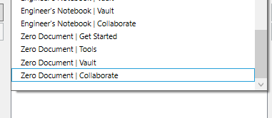

Macro button vanishes from ribbon after restart Inventor 2020 | Inventor 2020 | Autodesk Knowledge N...
I tried this workaround but with no luck, I could not find the "NullDocument ribbon" but I tried with the Zero document.

Unfortunately I cheered too early. after restarting inventor some of my buttons are gone again. i normally have 5 Ilogic buttons in my ribbon. now the Ilogic buttons disappear but the inventor buttons remain.
In the customize menu I can see that something strange is happening. the separators remain and the button "MP_Approved" is in the list but not in the ribbon. (marked in green)
I also saw that after the inventor reset utility many Ilogic macros are no longer in the list (marked in blue)
This screenshot is made right after starting inventor and creating a drawing
