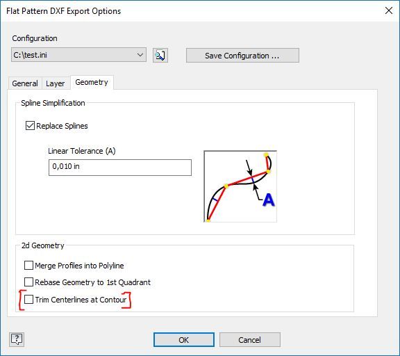

Hello all,
When I export a flat pattern there is the option to trim centerline at countour:
When using the ilogic export option i cannot seem to find the option argument needed to put it a "True"
EX: sOut = "FLAT PATTERN DXF?AcadVersion=2000&RebaseGeometry=True&SimplifySplines=False&TrimCenterlineAtContour=True&OuterProfileLayer....
Anybody figured this one out yet?

Ok for anyone else looking for an answer.
I presume this fix came in 2019 update 1. The correct string to use is: "&TrimCenterlinesAtContour=True"
