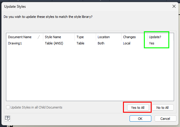

Hello.
I have been using this code to update styles to match the my client's standard. I found it on the forums, but cannot seem to locate the original poster:
Imports System.Windows.Forms
'Updates Drawing Styles To match active standard
Dim oCM As CommandManager = ThisApplication.CommandManager
Dim oCD As ControlDefinitions = oCM.ControlDefinitions
Dim oUpdateStyles As ControlDefinition = oCD.Item("UpdateStylesCmd")
oUpdateStyles.Execute2(False)
SendKeys.SendWait("Y ")
 It worked seamlessly for parts, assemblies and drawings, at least until I upgraded to 2027. I have migrated all of my styles using the Style Library Manager 2027.

WCrihfield
Hi @b.mccarthy.  The code example looks like it simply simulates the manual user actions of clicking on the 'Update' button on the [Manage tab -> Styles and Standards panel], then clicking the 'Yes to All' button (Y), then clicking the 'OK' button (space).  If any colors changed, it should have been because a style in the 'global styles library' had a different color than the local style that it overwrote during the update step.  Those specific color settings can actually be found in two different locations within the Inventor API.  Under the TableFormat object, and under the TableStyle object.  I believe the TableStyle is the primary source of drawing table appearance settings, then the TableFormat can be used sort of like an overlay or override to a subset if its appearance related properties where 'custom' tables are concerned.
TableFormat.InsideLineColor
TableFormat.OutsideLineColor
TableStyle.InsideLineColor
TableStyle.OutsideLineColor

JelteDeJong
When you send the key, I assume the "Y" is meant to confirm the "Yes to all" prompt. However, when I test this manually in 2027, the update appears to be applied only to the first style. I am not sure if this behavior was different in older Inventor versions.
Because of that, the SendKeys approach may no longer reliably update all styles.
You may get more consistent results by bypassing the command dialog entirely and updating the styles directly through the API. The following iLogic code updates all styles that exist both locally and in the library.
Dim doc As DrawingDocument = ThisDoc.Document
For Each style As Style In doc.StylesManager.Styles
    If (Style.StyleLocation <> StyleLocationEnum.kBothStyleLocation) Then Continue For
    Style.UpdateFromGlobal()
Next
This avoids UI automation. Howevere as @WCrihfield  pointed out you need to test this because some styles might not update as expected.
