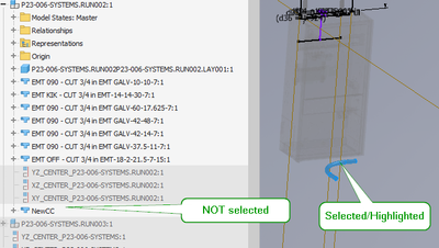

I have the code working like it should, IF I open the assembly in its own tab, which I do not want to do.  Open in its own tab, it truly "selects" the item i call in code, when in the master assembly however, it only highlights the component(s).  I'm looking for a way to run the below code, while I am in an active sub-assembly in the browser (see screen shot).  I cannot figure out why "DoSelect" ONLY works if the selected item is at the top level assembly level. Any ideas?
Dim AssyDoc As AssemblyDocument = ThisDoc.Document
CC = Components.AddContentCenterPart("NewCC", "Tube & Pipe:Fittings:Elbows", "EMT 090 - CUT", "3/4 in EMT GALV-10-10-7")
Dim C90 As ComponentOccurrence
C90 = AssyDoc.ComponentDefinition.Occurrences.ItemByName("NewCC")
ThisApplication.CommandManager.DoSelect(C90)

You have to also remember you can only change the part size while in edit mode of the sub assembly occurrence and you will need to do that while working through the browser node tree. Have you tried the recursion method linked earlier. I would expect you will need this eventually.

This rule here is working for me. The key is to edit the parent before selecting the occurrence this I believe will set the right context for the command to fire. Checking the active occurrence and exiting to the top will also ensure your not in another assembly and effectively reset the starting point for the editing.
Dim assyDoc As AssemblyDocument = ThisApplication.ActiveDocument
Dim assyDef As AssemblyComponentDefinition = assyDoc.ComponentDefinition
For Each occ As ComponentOccurrence In assyDef.Occurrences.AllLeafOccurrences
	If occ.Name = "Flange" Then
		Dim activeOcc As ComponentOccurrence = assyDef.ActiveOccurrence
		If Not IsNothing(activeOcc) Then
			activeOcc.ExitEdit(ExitTypeEnum.kExitToTop)
			occ.ParentOccurrence.Edit
		Else
		End If
		ThisApplication.CommandManager.DoSelect(occ)
		ThisApplication.CommandManager.ControlDefinitions.Item("CCV2ChangeSizeButton").Execute
	End If
Next
Regards
Alan
