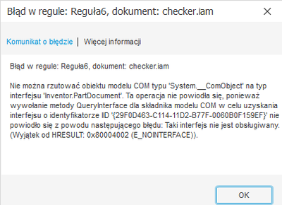

First of all I'd like to say I'm more of an amateur when it comes to programming and I'm using bunch of other peoples' macros and try to customize it for my needs (so it might be a messy code with some parts that probably could have been written better and differently).
I'm trying to complete my ilogic rule for exporting all flat patterns for sheet metal in an assembly. It works great, however I would love to run it in "invisible open mode" (time reasons, thats why I put a progress bar in there).
When I run it in "visible open" mode works like a charm, but when I change the parameter in line which opens the file to "False" (for open invisible) it pops up an error.
Is there any way to fix it?

EDIT:
Ok, I think it has to do something with part, when I call for:
oPart=ThisApplication.ActiveDocument
as it's not active when invisibly open...
I change that part for
oPart=oCurFile
and runs great.
However...
I've got the same problem with my mass .dwg export macro where I get file name from dialog box
Is there any way to define document variable when I have string name?
Apart from opening it and using "ActiveDocuments".

UPDATE:
Yeah, that .dxf macro seem to fail in bigger assemblies. 😕
Slakaz
Ok, as I can't edit earlier posts anymore I'll update You with my research outcome.
Whole "visible working"/ "invisible not working" comes to using "ActiveDocument" command, which is not working when file is open invisibly.
So as I reckon these two programs works when I replace "ActiveDocument". Check.

So right now I'm trying to modify these ones, so the programs I showed You in the first post would work.
When auto trigger is off, .dxf/.dwg macros seem to work without problem.
