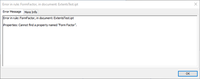

This is my error upon running with a trigger "on open". And, I am just opening a part...not an assembly with parts missing the iProperty.
And, if I run it after it opens...I still have the same issue...
WE don't use vault, so I know it's not a checked out part.
I even have "All Events Trigger" selected in my iLogic Security.
I have one rule running "after Save" that converts parts to STEP files, but since its not the same event, I can't see that would be an issue.

Message 13 of 15
lmc.engineering
Hi @RNDinov8r
Looks to me that you just need to change your logic here. We can just assume if it's not found the iProperty then we go straight to creating it. No need to add it as a blank and test for it's value in the same routine; that's likely your issue why it doesn't work; You need to update the document between creating the iProperty and testing for it's value.
The below should work better for you.
Dim ValueList As New List(Of String)({"Round", "Square", "Other" }) ' Add more options here if needed
Dim iPropVal As String
Try
	'See if the iProperty exists currently
	iPropVal = iProperties.Value("Custom", "Form Factor")
Catch ex As Exception
	'It doesn't exists, so create it
	iPropVal = InputListBox("Prompt", ValueList, ValueList.Item(0), Title := "iLogic", ListName := "Form List")
	If iPropVal Is Nothing Then Return ' User closed form before selecting option
	iProperties.Value("Custom", "Form Factor") = iPropVal
End Try

RNDinov8r
So, that was it... I needed it to fire on a new file creation, and had to prompt for input there as well, so I add thed last four lines...but this is what I needed. Thanks Guys!!!!
Dim ValueList As New List(Of String)({"ROUND", "SQUARE", "SHEET", "PURCHASED" }) ' Add more options here if needed
Try
End Try
