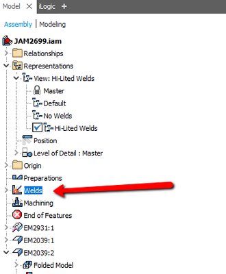

Gang...
Somewhat new to ilogic.
Attempting to select all visible components in an assembly and change appearance to a particular color.
Then I want to change the Welds to a different color.
Searched quite a bit and not finding anything.
Any help?
Thanks in advance,
Steve H.

Thanks Jelte...
Inserted your code recommendation into my logic and getting an error...
'Define current document
Dim odoc As Document
Dim oCompDef As ComponentDefinition
odoc = ThisApplication.ActiveDocument
oCompDef = odoc.ComponentDefinition
Dim oviewrep As DesignViewRepresentation
Try
oCompDef.RepresentationsManager.DesignViewRepresentations.Item("Hi-Lited Welds").Activate
Catch
 oviewrep = oCompDef.RepresentationsManager.DesignViewRepresentations.Add("Hi-Lited Welds")
 'Activate new View Rep
 oViewRep.activate
End Try
Dim doc As AssemblyDocument = ThisApplication.ActiveDocument
' set your collors/assets here
Dim assetOccurrences As Asset = doc.Assets.Item("Chestnut")
Dim assetWelds As Asset = doc.Assets.Item("Brass - Satin")
For Each occ As ComponentOccurrence In doc.ComponentDefinition.Occurrences
    occ.Appearance = assetOccurrences
Next
Dim weldDef As WeldmentComponentDefinition = doc.ComponentDefinition
weldDef.WeldBeadAppearance = assetWelds
'Turn off ALL object visibility
ThisApplication.ActiveDocument.ObjectVisibility.AllWorkfeatures = False
ThisApplication.ActiveDocument.ObjectVisibility.ConstructionSurfaces = False
ThisApplication.ActiveDocument.ObjectVisibility.Sketches = False
ThisApplication.ActiveDocument.ObjectVisibility.Sketches3D = False
ThisApplication.ActiveDocument.ObjectVisibility.SketchDimensions = False
ThisApplication.ActiveDocument.ObjectVisibility.Annotations3D = False
If odoc.DocumentType = kAssemblyDocumentObject Then
  ThisApplication.ActiveDocument.ObjectVisibility.WeldmentSymbols = True
  ThisApplication.ActiveDocument.ObjectVisibility.Welds = True
End If
Think it has something to do with lines that set the colors...but I'm not good enough to decipher.
Again...Thanks so far. Getting closer 🙂

Thanks for all the help thus far.
Getting back into this code. I thought I had it running, but getting an error. Have to manually set colors first. After I do that and delete the view rep out...then ilogic will run.
Here's a video showing what is happening....
https://autode.sk/2K6xL00
