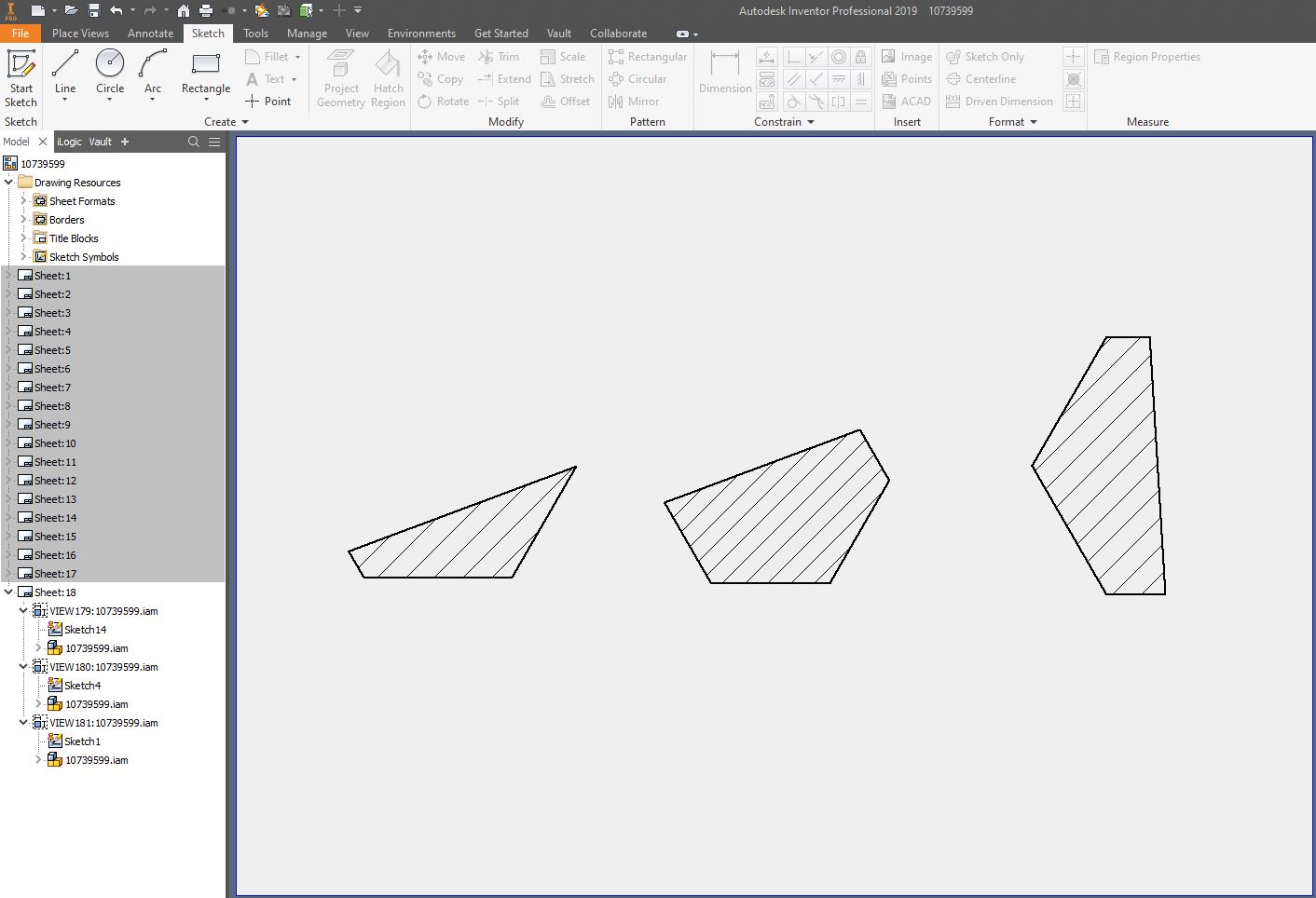

 I have included 2 screen shots with my post:
"OriginalViewsOnSheet.jpg"  - Shows the sheet before running the rule
"HatchedViewsOnSheet.jpg" - Shows the sheet after running the rule (what I want the rule to do)
Any help would be much appreciated.

I found a solution to my problem. My code works now, but it doesn't apply a hatch. Instead, it applies a Solid fill. Inventor 2019 API does not support to application of a hatch pattern to a profile, only a solid fill. Apparently this feature is coming to Inventor 2021.
See the attached images.
