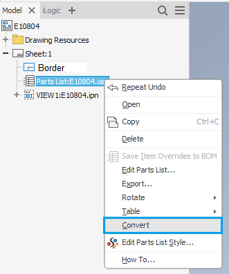

Hello Autodesk Community! This is my first post here, I have been lurking the forums for a few weeks now trying to learn how to automate opening all the IDWs relevant to the production of a product. I want to thank the members of this community for their contributions, I've learned and pasted a lot from here.
Using Inventor Pro 2022 and Vault Basic 2022, this external Ilogic Rule sometimes successfully runs on a top level assembly IDW. For each row in the parts list, the rule opens the ipt or iam referenced and calls OpenVaultIDW which gets and opens the active document's corresponding IDW from the vault; OpenVaultIDW then closes the ipt or iam.  If the referenced parts list row is an assembly then after OpenVaultIDW ends, the main sub in this rule calls itself recursively. This code works on some assemblies and does not on others. I am pretty new to VBnet and Ilogic, and am struggling to figure out what is wrong with this code; Any help or advice would be greatly appreciated.
This is the parts list for my example: "Test Assy.idw" both items are sub-assemblies containing multiple parts
ITEM    DESCRIPTION            QTY      PART NUMBER
1       ARM, SUB, FOAM, RH      1       E10804
2       ARM, SUB, FOAM, LH      1       E10818
I get this error after E10804.idw is opened
Error in rule: OpenAll, in document: Test Assy.idw
(Error Message)
Unspecified error (Exception from HRESULT: 0x80004005 (E_FAIL))
(More Info)
System.Runtime.InteropServices.COMException (0x80004005): Unspecified error (Exception from HRESULT: 0x80004005 (E_FAIL))
   at System.RuntimeType.ForwardCallToInvokeMember(String memberName, BindingFlags flags, Object target, Int32[] aWrapperTypes, MessageData& msgData)
   at Inventor.DrawingBOMRow.get_BOMRow()
   at ThisRule.Main()
   at ThisRule.DupeCheck()
   at ThisRule.Main()
   at Autodesk.iLogic.Exec.AppDomExec.ExecRuleInAssembly(Assembly assem)
   at iLogic.RuleEvalContainer.ExecRuleEval(String execRule)

Hi @Mac_W.  That is a tough one to diagnose.  The error message indicates that it is encountering a problem at a location within your code where you are trying to access the regular BOMRow object from a DrawingBOMRow object, through its property (DrawingBOMRow.BOMRow).  I can see 2 places like that in your code.  Both are on the second line within the Try side, and the Catch side of your inner most Try..Catch block of code, within your Sub Main block of code.  I am not sure why it would be encountering a problem at that specific step.  I assume that would indicate that the row exists on the drawing side, but not on the assembly side, but I am not sure.  According to this API Sample code (which is in VBA, not iLogic), you may need to check the DrawingBOMRow.Custom property at that stage, if that is a possibility.  If that property returns True, that would indicate that the DrawingBOMRow is a custom one, in which case, there would not be a BOMRow object on the assembly side for it.
Another thing that you may need to deal with is ModelStates.  If any of the files involved have more than just the one default ModelState included, that would mean that the file on disk will contain multiple Document references within.  And when that is the case, you have to make sure you are dealing with the right Document within that file.  I noticed that you are using the Documents.Open method within your code, but you are only supplying the FullFileName to it.  It will become more important from now on to use the FullDocumentName in those types of places.  The FullDocumentName starts with the FullFileName, but then sometimes it has more information after that to indicate which specific iPartMember or ModelState Member within that file you want to target/reference.
Wesley Crihfield
(Not an Autodesk Employee)
Mac_W
@WCrihfield Thanks for helping diagnose the cause of the error and providing excellent reference documentation! I also appreciate your suggestions and have changed my use of FullFileName to FullDocumentName, I haven't tested this on any Iparts or Iassemblies yet but we do have a small percentage of products that utilize them and it would be great if they were compatible.
After reading your post and the links your provided I did some more digging into the differences between the drawings and Boms that this rule works on vs doesn't. I think the error happens when a drawing's parts list uses "BOM View: Legacy Structured" If I right click on the parts list and click "Convert" then when I run the rule again, it executes without issue. I'm now trying to figure out how to Convert the parts list automatically in the rule but I am struggling to figure out how I would do that. Bellow is a picture referencing how you could manually convert the parts list.
I've also made some changes to my rule to handle situations where a part or assembly doesn't have an IDW (ex: nuts and bolts) Bellow is my updated code including the OpenVaultIDW rule and an additional rule that helps handle a potential issues of top level drawings finding themselves in the list(infrequent issue and I don't really know why it happens but this seems to fix that)

A.Acheson
Hi @Mac_W
You can find it from the command list API help here. With keyword convert or partslist.
With the partlist preselected run the below command. The trick then is to have the partslist object or browser node preselected which is another mission.
Dim oControlDefs As ControlDefinitions = ThisApplication.CommandManager.ControlDefinitions
oControlDefs.Item("DrawingPartsListConvertToBOMCtxCmd").Execute
Regards
Alan
Mac_W
Thanks @A.Acheson! That list of command names and their descriptions is super useful. I also appreciate the command code you posted and the advice you gave on what I should do before executing it. The rules seem to work on everything I've tested so far, thanks again everyone!
This is my updated logic to handle if a parts list needs to be converted:
'Source: https://forums.autodesk.com/t5/inventor-ilogic-and-vb-net-forum/ilogic-parts-list-amp-opening-drawings/td-p/5976549

This new rule selects a parts list and converts it for each parts list on the active sheet:
'source: https://modthemachine.typepad.com/my_weblog/2009/03/running-commands-using-the-api.html
Sub Main()
    ' Get the active document, assuming it is a drawing.
    Dim oDrawDoc As DrawingDocument
    oDrawDoc = ThisApplication.ActiveDocument
    ' Get the collection of partslists on the active sheet.
    Dim oPartsLists As Object
    oPartsLists = oDrawDoc.ActiveSheet.PartsLists
    ' Get a reference to the select set and clear it.
    Dim oSelectSet As SelectSet
    oSelectSet = oDrawDoc.SelectSet
    oSelectSet.Clear
    ' for each partslist select it and convert Bom
    Dim PartsList As Object
    For Each PartsList In oPartsLists
        oSelectSet.Select(PartsList)
		Call ConvertBom()
		oSelectSet.Clear
    Next
End Sub
Sub ConvertBom()
End Sub
