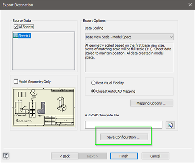

I wanted it to export the associated drawings in .dwg (file > export > .dwg) when you do this it gives you a "different" type of dwg

I didn't understand that you wanted to create Autocad Dwg file. These are a bit more difficult to make. for that to work you need to save a DWGOut.ini file (= configuration file). You can just save the settings you use when you create an Autocad Dwg manually.
the rule expects that you save that file on "C:\temp\DWGOut.ini" but you can save it anywhere but then you need to change the location in the rule. (see comments in the rule.)
This script will go into all files referenced by the assembly (also sub-assembly parts).  but for the script to work the dwg file name and part/assembly file name must be the same.
