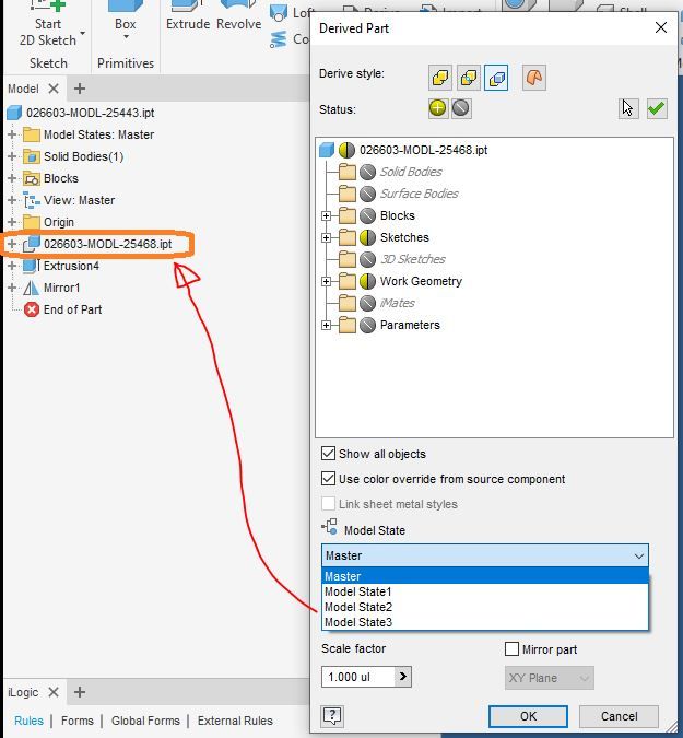

The skeletal model was ok  - thought setting model states in the sketch would would but a secondary part is derived & the drop down show the model states but this doesn't update - not sure if ilogic can drive this selection, it's already looking a bit complicated.. but it nearly works.

Message 11 of 21
Frederick_Law
Model State is still in development.
Next update might break what you're doing or make it better.
