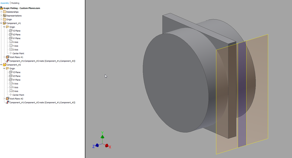

Right, so here's my assembly (files attached) that runs with this rule:
One thing I noticed is that after saving the two files with the "Component_#1" & "Component_#2" filenames I had to normalise the names within the assembly because they end up with "Component_#1:1" & "Component_#2:1" instead.
Normalisation removes the ":#" from the component name at assembly level and then OP's original code works correctly.
