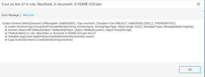

For line 18, activeSheet.AddTitleBlock(templateTitleBlock, , sPromptStrings), I am getting the error "The parameter is incorrect". I don't understand why as the syntax and inputs are all as they should be. Please help!

I added that code snippet and still no luck. Is there some other way i can add new sheets so that they already contain the formatting of the original sheet in the drawing?
I tested out the code as a separate rule and got a Type Mismatch error for the same line of code (line 27). And yes, I am certain the title block contains two prompted entries.

Ah, my bad! i declared templateTitleBlock now and am getting the same parameter incorrect error as before. So strange because its a simple enough rule. Going to give up on this now and create a SheetFormat. Thanks!
