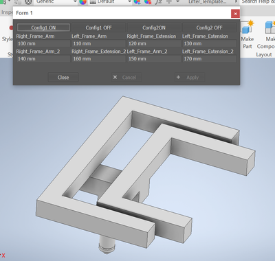

This is where I'm at right now. (Config 1 & Config 2 correspond to the smaller and bigger "C" shapes respectively). For reference, How would I go about putting "tabs" into a form like this?

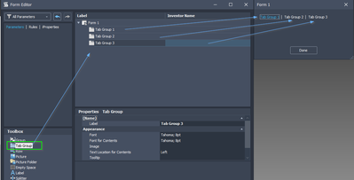

Create the tabs and then drag the fields into the respective tab.

Observing your form, i suppose you only need two tabs (config 1 and config 2) and two buttons (on/off).
