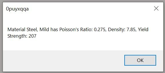

I noticed that there is discontinuity between the Inventor material database, and the values the code presents:

Values reported by iLogic Code:
The Material and Poisson's Ratio are good, but the Density and Yield Strength do not match. Why are the values so different, and what tweaks need to be made to the code to display the data correctly?

TomaszDąbrowski
That is because the units are different.
Yield strength is given in MPa (mega Pascal)
Density is given in g/cm3 (gram per cubic centimeter)
