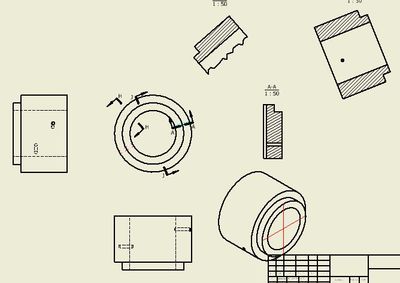

I would like a code to delete all Center Of Gravity symbols (only in active sheet).
Any suggestions? Thanks!

Hi, I mean this symbol. Maybe it is called something else than Center of gravity?
Message 5 of 17
This is Origin Indicator (for Ordinate Dimensions).
You can hide it:

Can you show what happens when you right-click this symbol?
What appears?
Message 10 of 17
This: 
Message 11 of 17
It looks like a sketch. A symbol drawn in sketch of the view.
Try double-clicking on in - it should trigger sketch editing.
If so, we can delete all sketches but that can delete also other things.
Message 12 of 17
Yes, if I delete the sketch then the symbol will also be deleted.
Is it possible to code that all sketches with these symbols will be deleted?
Message 13 of 17
I don't think so.
Please edit this sketch and check what makes this symbol. Is it just circle, lines and filled region? Or maybe some block?

In browser it looks like this: 
In sketch it looks like this, seems like it is a circle with lines, however I am not able to edit it:
Message 16 of 17
Is the name of this sketch always "Sketch1"?
Is deleting all sketches an option?
Message 17 of 17
tomasz: It's not always sketch 1. I guess I have to delete it manually then.
