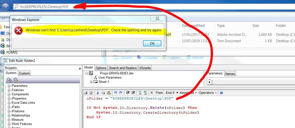

Hello
I've copied some code to create pdf's but the folder isn't being created.
(I've changed the path).
Copied out the folder code (as below)  - ideally i'd like all users to be able to output to their desktop areas.
No error messages are returned  - wondering what's happening?
oFolder = "%USERPROFILE%\Desktop\PDF"
If Not System.IO.Directory.Exists(oFolder) Then
    System.IO.Directory.CreateDirectory(oFolder)
End If
Regards
Andrew

JhoelForshav
Hi @andrew_canfield
Does this work for you?
Dim oFolder = Environment.GetFolderPath(Environment.SpecialFolder.Desktop) & "\PDF"
End If

andrew_canfield
Thankyou - the code works.
