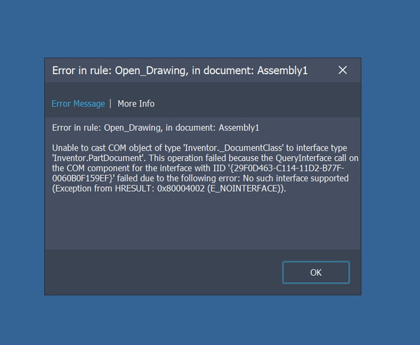

Do you know how to get this running on an assembly? Currently throwing an error
I can change the PartDocument to an AssemblyDocument and it runs however I'm just not sure how to leave it looking for a part, but  catch the error and run as an Assembly Doc instead?
This feels like a simple thing - but it doesn't quite compute yet/
Imports System.IO
Dim oDoc As PartDocument
oDoc = ThisApplication.ActiveDocument
'change this to
Imports System.IO
Dim oDoc As AssemblyDocument
'But if I try to run two variables I get stuck in the Try loop
Dim oAsm As AssemblyDocument
Dim oDpc As PartDocument
oAsm = ThisApplication.ActiveDocument
Try 'to open the drawing
	ThisApplication.Documents.Open _
	(ThisDoc.PathAndFileName(True).Replace("ipt", "idw"))
	Return 'exit rule
Catch
	(ThisAsm.PathAndFileName(True).Replace("ipt", "idw"))
	Return 'exit rule
End Try
'I'm just not sure how to catch the failure and turn it into opening an assembly doc.

Curtis_Waguespack
Hi @liam.dewhurstNMKYG
Maybe just something like this.
I hope this helps.
Curtis
Imports System.IO
Dim oDoc As Document
oExt = Right(oDoc.FullDocumentName,3) 'get file extension
	(ThisDoc.PathAndFileName(True).Replace(oExt, "idw"))
	Return 'exit rule
Catch
End Try
'since nothing found create it...
oNewDrawing = ThisDoc.ChangeExtension(".idw")
oTemplateFolder = ThisApplication.FileOptions.TemplatesPath
Dim oList As New ArrayList
Dim Folder As New IO.DirectoryInfo(oTemplateFolder)
For Each File As IO.FileInfo In Folder.GetFiles("*.idw", IO.SearchOption.AllDirectories)
	Dim sName As New FileInfo(File.Name)
	oList.Add(sName.Name)
Next
oTemplate = InputListBox("Select a template", oList, oList(0), "iLogic", "List")
oTemplate = oTemplateFolder & oTemplate
Logger.Info(oTemplate)
Dim oDrawingDoc As DrawingDocument
oDrawingDoc = ThisApplication.Documents.Add _
(DocumentTypeEnum.kDrawingDocumentObject, oTemplate, True)
oDrawingDoc.Activate()
Dim oSheet As Sheet
oSheet = oDrawingDoc.Sheets.Item(1)
Dim oPoint As Point2d
oPoint = ThisApplication.TransientGeometry.CreatePoint2d(10, 10)
Dim oView As DrawingView
oView = oSheet.DrawingViews.AddBaseView(oDoc, oPoint, 1, _
ViewOrientationTypeEnum.kFrontViewOrientation, _
DrawingViewStyleEnum.kHiddenLineRemovedDrawingViewStyle)
