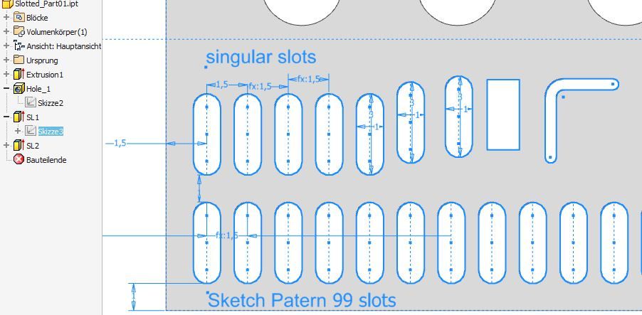

Alex.Shechter
the attached files were created with Inventor 2021.
Message 7 of 15
Alex.Shechter
I don't mind working with restrictions like specificpProfile or sizes as long as it works but the question is,
how do you make Inventor to count any geometry/extrussions of a feature at all?

Message 11 of 15
Alex.Shechter
I have experimented with this and as you can see the code works just fine , it counts over 99 and it counts diffrent shapes and ingular objects and pattern objects alike.
The only thing is, I tried to use this same code to count holes and it doesn't work for some reason. It seams to me I am missing something for the HoleFeature definition.
