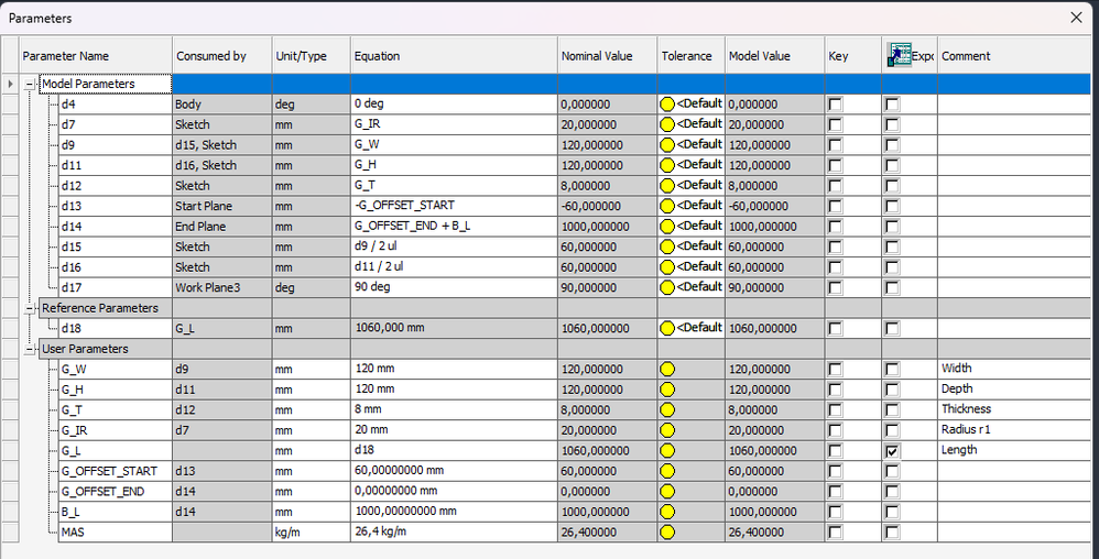

I have a Ilogic code( check below for code) that create few custom iproperties and userparameter(Image 1) and use pick tool to pull data about the part. in that there is user parameter "LengthM" that pulls length of somewhere , but i want it to pull from the data i mentioned in image 2.

Hi @khantheking1995 . The length parameter is implemented here:
oLengthM.Value = oDef.Parameters.UserParameters("B_L").Value
You need to change "B_L" to "G_L".
oLengthM.Value = oDef.Parameters.UserParameters("G_L").Value
But you need to make sure that this is the name used by all profiles for the length parameter:
