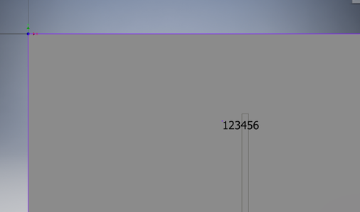

rzsla
Hello, I am using a code almost similar to this. The problem I am facing is, when I enter the FlatPattern Edit. Inventor takes the longest edge and puts it along the X-axis. But, Sometimes, the perpendicular side of the edge is in negative Y-axis. Hence, the value otg.createpoint2d(1.1,1) is etching part numbers in space that doesn't show on the part irl.  I only want help with the textbox location. i.e grabbing the edge that lies on the X-axis (longest edge in this case) and making sure the Y-value is inside the part. Be it +ve or -ve y-axis.
Also, it is crucial that I do not change the orientation of the flat pattern. (I can not make all -ve y-axis parts +ve)
Edit: I am attaching pictures and code for you to see.

marcin_otręba
hi,
you can try:
 If oSketch.NaturalAxisDirection = True Then
    oTextBox = oSketch.TextBoxes.AddFitted(oTransGeom.CreatePoint2d(0.5, 1.2),  nnname)
 End If
 If oSketch.NaturalAxisDirection = False Then
    oTextBox = oSketch.TextBoxes.AddFitted(oTransGeom.CreatePoint2d(0.5 + 6.4, -1.2), nnname)
    oTextBox.Rotation = 4 * Math.Atan(1)
End If

rzsla
That works beautifully, I searched all over the Api help to look for something like natural axis but was unable to do so. Do you mind sharing how you came about to knowing its existence. So that, I can continue to learn and grow.
Thank you once again.
