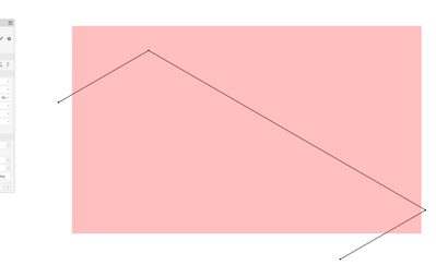

Hello Forum,
I got this grid of 3d sketches created with code
And the idea is that you can select the lines and make a frame.
The engineer has to manually select all the lines, then press 'Insert Frame'
Now the Frame Generator code does not seem supported in the API.
But I can do this:
.CommandManager.ControlDefinitions.Item("AFG_CMD_InsertProfile").Execute()
- Select the lines
- 3x enter
My problem is with step 2: select the lines.
Because in the context of the assembly, the SketchLines3d are SketchLines3DProxy.
So how to get the SketchLines3DProxy after determining the SketchLines3d
How do i get them in a SelectSet for frame generator
We tried:
Occurrence.CreateGeometryProxy(line, lineproxy)
A bit like how sketch dimensions is done here:
https://adndevblog.typepad.com/manufacturing/2016/03/retrieve-sketch-dimension-of-part-document-insi...
But we cant seem to get it to work.
Any help is greatly appreciated!

Cadkunde.nl
Hello Haines,
Thank you for your reply.
Actually we want to accomplish the opposite.
We know how to find all the sketchlines3d (native objects) in the sketch3d.
We go from assembly, to occurrence document to sketch3d and then put all the sketchlines3d in a selectset.
But then it gives a error, my guess because we are selecting the object not as a proxy in the assembly.
But how to do that?
With workpoints/planes/axes you make a proxy with transientgeometry. But we fail to do so with sketchline3d
There is a sketchline3dproxy object in the API.
We dont know how to tie these things together and make it a working selection to framegenerator.

hi, this is blind road because it will not work, just select couple lines before clicking insert frame and you will see that it will be reseted.
Frame generator sadly is not supported by api.
You can help your designer by giving him hint that instead of clicking each line he can:
1. select all lines using mouse extend window selection
2. select sketch from treee - all lines from sketch will be selected.

Well we got something 'working'
But this whole asynch task does not feel reliable
But if we select the nodes without asynch task, it gets selected, but not added to frame generator selection.
I hope someone has a better solution
