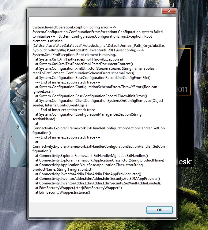

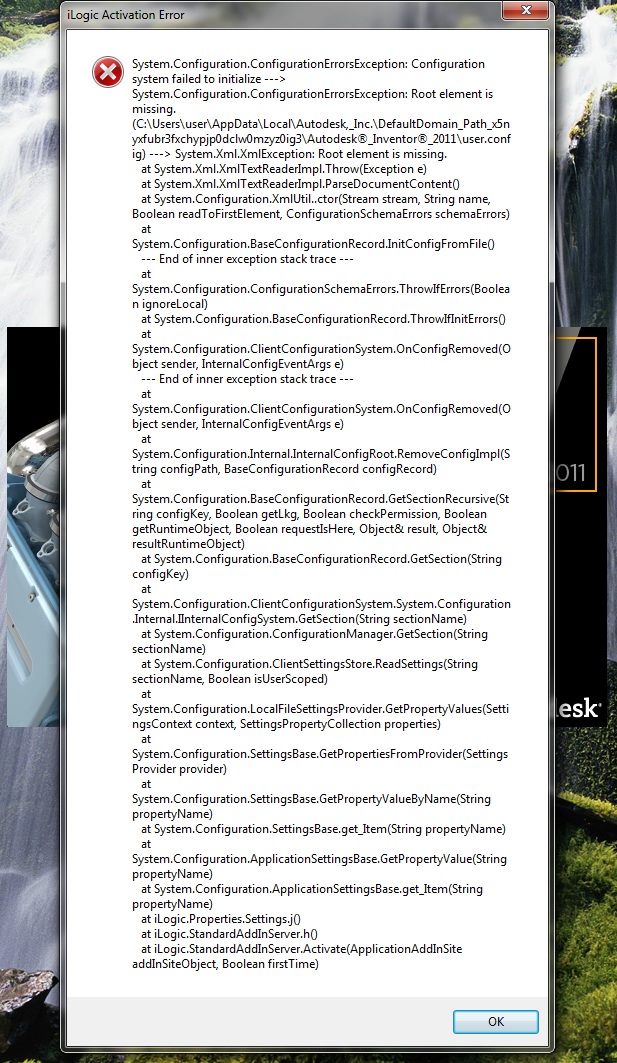

When I start program iLogic Activation Error show on display (see Pic)
when I click "OK"  I can access in program
I don't know this error affect to program or not

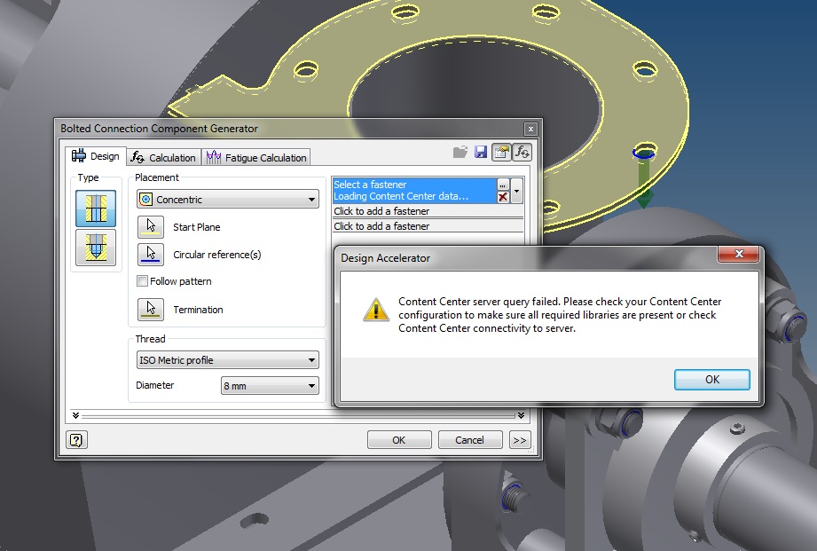

but 1 error I got is form Content Center , when I use "Bolt Connection" and click "Select a fastener Loading Content Center data..." then Error box is show (see pic.) and program is close
how I can solve tis problem,

MjDeck
I'm not sure if the Content Center error is caused by this error.
To fix the error: close Inventor and then use Windows Explorer to delete the file named  user.config  in the folder:
C:\Users\user\AppData\Local\Autodesk,_Inc.\DefaultDomain_Path_x5nyxfubr3fxchypjp0dclw0mzyz0ig3\Autodesk®_Inventor®_2011
This filename is shown in the error dialog.

Thank you MIKE,
When i delete file  user.config  all problem solve
- iLogic error not shown when start
- Content Center in Bolt connection not error
