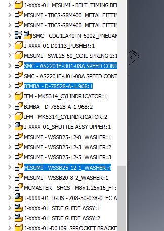

Message 12 of 16
HideoYamada
Finally I got it!
Select Multiple NodesSelect Multiple Nodes
Option Explicit
Private Declare PtrSafe Function GetKeyboardState Lib "user32" (pbKeyState As Byte) As Long
Private Declare PtrSafe Function SetKeyboardState Lib "user32" (pbKeyState As Byte) As Long
Private Const VK_CONTROL = &H11
Private keys(256) As Byte
Private save As Byte
Private Sub SetCtrlKey()
    GetKeyboardState keys(0)
    save = keys(VK_CONTROL)
    keys(VK_CONTROL) = &H80
    SetKeyboardState keys(0)
End Sub
Private Sub ResetCtrlKey()
    keys(VK_CONTROL) = save
End Sub
Private Sub SelectPartsLoop(nodes As BrowserNodesEnumerator)
    Dim node As BrowserNode
    Dim occ As ComponentOccurrence
    For Each node In nodes
        Set occ = Nothing
        On Error Resume Next
        Set occ = node.NativeObject
        On Error GoTo 0
        If Not occ Is Nothing Then
            If Left(occ.Name, 3) = "JIS" Then
                node.DoSelect
            End If
        End If
        SelectPartsLoop node.BrowserNodes
    Next
End Sub
Sub SelectParts()
    Dim obj As Object
    Dim dDoc As DrawingDocument
    Set dDoc = ThisApplication.ActiveDocument
    Dim nodes As BrowserNodesEnumerator
    Set nodes = dDoc.BrowserPanes.Item("DlHierarchy").TopNode.BrowserNodes
    SetCtrlKey
    SelectPartsLoop nodes
    ResetCtrlKey
End Sub
I found that BrowserNode.DoSelect kept already selected items when I held down the control key (yes, on physical keyboard).
So if the keyboard state is changed as a control key being pressed by Win32 API, DoSelect keeps last selecting.
The above code will select all occurrences whose name starts with "JIS" as shown in the screen capture.
How is this?
