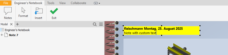

Hello, I am new to the Inventor API and I am writing an AddIn.
I want to add a Note (the ones that are shown/can be viewed in the Engineers Notebook) to the active document.
I have only found information about DrawingNotes, GeneralNotes, LeaderNotes, etc. but not about these types of Notes that can be on any type of document.
Is this even possible to do programatically and if yes via which interface/object on the Inventor.Application object?
I am sorry if this question has been asked before, I did not find anything about these Notes.

Hi @fleischmannHVTJ3.  I do not think they have exposed those abilities through Inventor's API yet.  We do have access to the related Application.NotebookOptions property, which returns the NotebookOptions object, which appears to provide equivalent control to the 'Notebook' tab of the Application Options dialog.  But I could not find true API methods for adding new notes of that type into documents.  We can access the 'commands' (ControlDefinitions) which exist behind the manually accessed user interface controls.  But attempting to use those would be like trying to 'simulate' manual mouse &/or keyboard user interactions, and not the same as API automation.  Executing the command behind the one controls would likely just visibly change the 'Environment' to the Engineer's Notebook one, and initialize the user interface for manual user inputs (editing a note).  There would not be any intuitive way to do the required following actions, such as entering text and/or editing the format of the text, and so on.
Below are some of the 'Commands' that I found in a search of all commands, which had the 'Notebook' text in their name.  They are just the names of ControlDefinitions, not the names of API methods.
