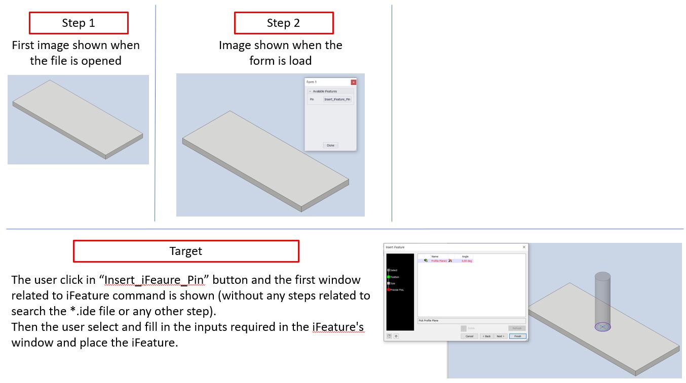

Hello fellow inventor’s Experts
I am facing the needs of launch an iFeature using only one button located in a form.
I am already have an iFeature developed and working 100%.
Currently, when I need to insert this iFeature is required to go to Manage > Insert iFeature and use the browser to be looking for this iFeature *.ide files.
My target is to reduce this process for one only button and eliminate all other steps.
My idea about how this is going to work is to create a code that automatically will insert the iFeature.
This code will contain the commands and the path where the iFeature is stored.
Once all my iFeaures (*.ide) files are stored in only one path I believe that is possible to programming a button to reach and insert a specific iFeature.
I have an idea how this could work, but I don’t know how to create the code.
I would like to get help from the colleagues to build this code.
I have attached the file with the form and the button that will receive the code;
I have also attached a workflow to helps to clarify my idea;
And I have attached the iFetaure file to reduce the time of the colleague that will help.
I am available to supply any other necessary information.
Thanks in advance for everyone that can help.

@moraesorlando
Create a rule like this and add it to your form 🙂
'ifeature filename
Dim _iFeature As String = "C:\Users\Public\Documents\Autodesk\Inventor 2020\Catalog\Punches\curved slot.ide"
'get commandmanager
Dim cmdMgr As CommandManager = ThisApplication.CommandManager
'Post filename to commandmanagers internal clipboard
cmdMgr.PostPrivateEvent(PrivateEventTypeEnum.kFileNameEvent, _iFeature)
'Execute ifeature command
cmdMgr.ControlDefinitions("PartiFeatureInsertCmd").Execute

Hello @JhoelForshav !!!
Once again you solved the case. It is exactly what I was expecting!
Thank you very much. I have already gave you the deserved like. Just one more thing before mark this post as solved.
