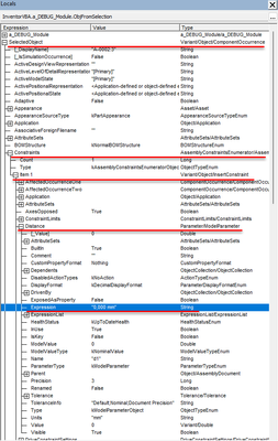

I have written logic that gets a constraint that I want to change the associated dimension of. I am able to find the constraint and the name of the constraint, but I haven't been able to determine how to link the constraint to the parameter that stores the dimension value. What am I missing?
I can see in the Parameters menu that the parameter name is "d1", and that it is consumed by constraint "mate:1", but iLogic seems to act like there is no reasonable bridge linking the parameter and the constraint.

Every assembly constraint contains reference to its parameter, but how to access them depends on constraint type. You can see API reference or you can use tools such as VBA Object Browser for Inventor to find the appropriate property of constraint you want.
Sample for MateConstraint and InsertConstraint
duke
Thank you! It seems that I was looking in the right place, but I did not realize that every constraint type had to be individually declared in order to access its parameters. I was able to get the program working after following your tip and declaring the specific constraint type.
