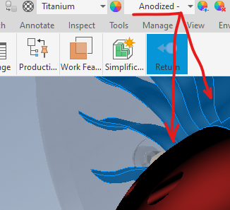

Hi there!
I'm trying to get render data (such as diffuse color, roughness and so on), and faced that RenderStyle from Material contains material color (titanium on the screenshot below), but I need a representation color (Anodized - dark red), and I can't find how to get it.
Does anybody know something about this all? 🙂
Thank you!

Thanks for your reply!
Actually, I'm trying to collect physical-based data, such as color, opacity, refraction, and so on.
And in this particular case, I faced this anodized appearance of titanium and I need to get RGB data of it... and I can't find how 🙂
Your snipped doesn't work on my side - throws COM exception (I use C#), but thanks to your idea I found that I can get the surface body's Appearance through SurfaceBodies from ComponentOccurrence. And that's correct Appearance, but this appearance struct (Asset) doesn't contain information about the color which I'm looking for...
