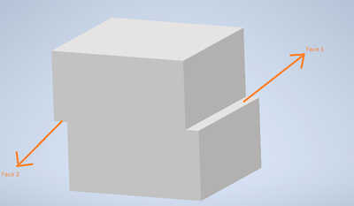

I want to highlight only the faces which are intersecting. With using below code i am able to get interference between parts and highlite the parts completly.

//But i want to get only the faces which are intersecting like below pic.

It is not designed to return faces.  We can only get what the InterferenceResult object gives us.
InterferenceResult.Centroid
InterferenceResult.InterferenceBody
InterferenceResult.OccurrenceOne
InterferenceResult.OccurrenceTwo
InterferenceResult.Volume
The closest would be the InterferenceBody property, which returns a SurfaceBody, then iterate through its SurfaceBody.Faces collection, inspecting each one somehow.
Wesley Crihfield
(Not an Autodesk Employee)
Frederick_Law
By definition there are 4 intersected faces on each body.
Need more criteria to remove other intersected faces.
Face 1 and Face 2 are not the only intersected faces.

I tried some work arounds but not  succeeded.
Dim surfaceBdy As SurfaceBody = oResults.InterferenceBody()    //Going to the Inventor UI but not coming back to the code //
Dim FaceCol As FaceCollection
FaceCol = surfaceBdy.Faces
