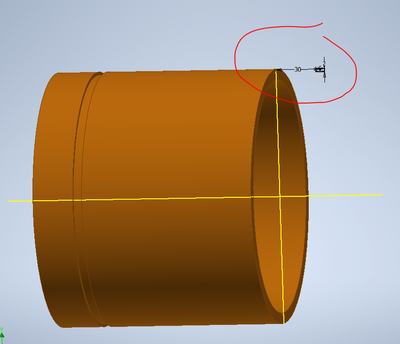

I would like to put a groove on a pipe by selecting either end face. The problem arises in knowing which direction to send the rectangle to only cut within the tube. Any one know how to go about positioning the sketch within the range box of the solid body?

Hi @A.Acheson . I suggest you measure the distance between two vertical lines (those perpendicular to the pipe) and then measure the distance from your sketch (rectangle) to these lines. So that the distance is not greater than that between the lines. And it doesn't hurt to add a selection of faces to which to bind your sketch. So that the user can choose whether the insert will be at the beginning or at the end of the pipe.

If your pipe axis is parallel with an origin axis, then you can determine which direction is positive or negative for that specific axis, by comparing that to the Normal of the pipe's end face you are Picking, to see if they are the same direction or not.  If they are the same direction, then you know that the picked face is pointing in the positive direction, and know to use negative numbers to position the rectangle rearward from that face, to be along the pipe, instead of out in front of it.  This means more code, but once the code is done and working, code length doesn't matter much anymore.

Thanks @WCrihfield and @Andrii_Humeniuk  I will give those recommendations a shot and see how I go. I do know that one end will have the origin and one won't so the extrusion should be in one direction or another based on the origin. Assuming I'm using consistently modeled parts from the content center.
