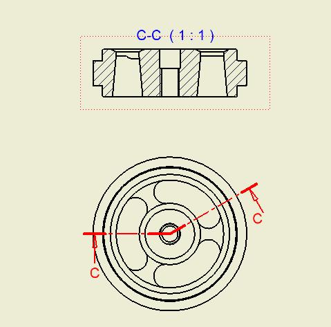

sir,
I want to know how to create secton view as shown in attached image file through API.
Can u send me the detail code for it.
Regards,
Hemant

Attached is a program that demonstrates this.
The attachment contains a part that I used to test with and a text file
containing the program.  The program associates the position of the section
line to the center of the part, but it could also use some other associative
relationships to fully define its position if the part is modified.
