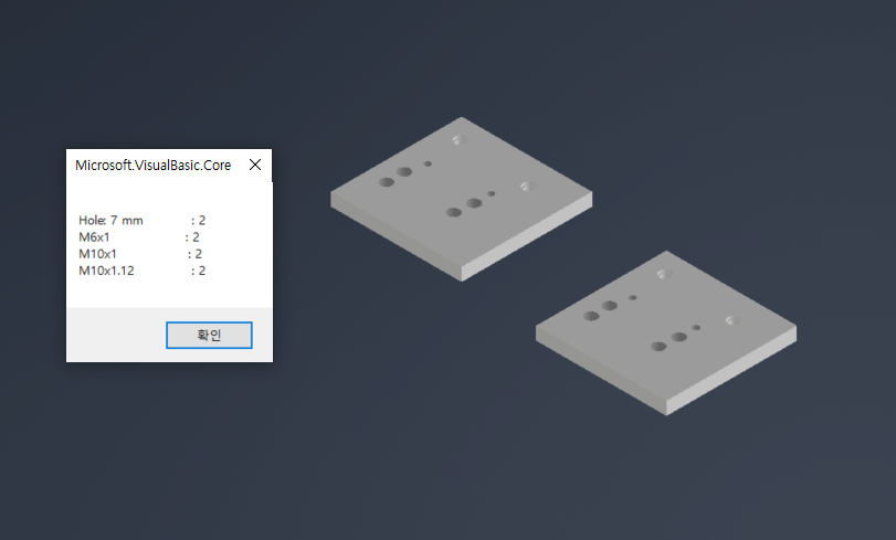

What I would like to ask is, is it possible to configure logic to identify the number of tabs used in an assembly, not all hole features, by type?
The message box is expressed as follows.
ex) 10 M3s, 2 M5s, etc.
I think it would be possible to configure the message box to display the type and number of holes by utilizing the part about HoleType.
Is it possible to configure it with logic?

HYOSEOK-KIM
Hello.
Thank you for your reply. There's something that needs to be corrected.
The logic reads the feature name "hole" and expresses it as a count.
The count I'm looking for is different information.
For example, assuming [Assembly 1] contains one [Part 1] and two [Part 2],
[Part 1] Hole1 feature contains two M6x1s, and Hole2 feature contains three M10x1s.
[Part 2] Hole1 feature contains one M6x1.
When executing the logic, I'd like the count results to be expressed as:
M6x1 = 4
M10x1 = 3
Concept:
- This is an assembly document.
- The total number of holes is ~.
- Of these, the number of holes with the "tap" attribute is ~.
- Of all the tap holes, the result would be ~ for "m1" and ~ for "m2"...
Is it possible to configure it with Inventor iLogic as above?
