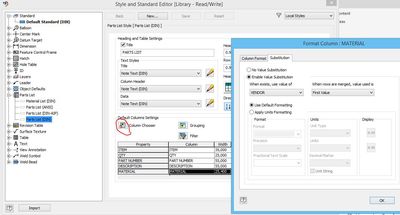

I need the property von Partslist as shown in the dialog.
As I use a german Inventor I can't tell you the exact naming, but please have a look at the picture.
The Red marked Bauteilliste (1) meens Partslist and Werkst./Lieferant (2) means material/vendor.
I need excatly this property, it delievers only vendor if defined, and material if there is no vendor.
Your solution isn't compatible with our PDM Solution.

Hi @wolfgang_nickl . How did you put it under Partslist (manually)? I dont have that option. And also cannot create a custom parameter with that name. I have to find out.

with an open Drawing I go to Ribbon Manage (German: Verwalten) -> Styleeditor (German: Stil- und Normeneditor) -> Partslist (German: Teileliste (DIN)) -> Columnselection (German: Spaltenauswahl) and thats the dialog you can see in the previous picture. The next two pictures show the way.

Hi @wolfgang_nickl . So, what you need is an ilogic to do the same as the substitution option. sUBS.JPG
