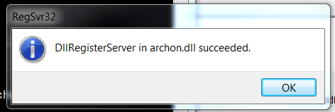

Message 4 of 11
@Anonymous wrote:
"I try add reference "archon.dll" but give me a error "a reference to c:\....\archon.dll could not be added. Please make sure that the file is acessible, and that is a valid assembly or com component." I try registry the "archon.dll"but no success."
I had the same issue with Inventor 2015. I resolved it as follows
Go to start and in the search box type in "CMD"
type in "CD program files\autodesk\program files\bin" then press enter
type in "regsvr32 archon.dll" and press enter
You should get a dialog box that says "DLLRegisterServer in Archon.dll succeeded"
Then you should be good to go
Below you should be able to see my screenshots of doing it on 2015.

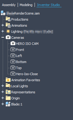

_KarlH
Accessing Inventor Studio via iLogic is a game changer! Does anyone have any links handy to supporting documentation for the Studio Add In?
Also some feedback - I've found that this iLogic Inventor Studio batch rendering will only work when the Render Settings held within the Inventor Assembly or Part file is set to "Render by iteration" via the Renderer settings found in "Render Image" control panel. If this setting is set to "Render Time" then iLogic will output a batch of blank images - at least in my experience.
Keen to know if others have also experienced or fixed this issue.
Message 11 of 11
_KarlH
Just a side question on Inventor Studio and batch rendering via iLogic - is there a method to check if the Inventor Studio Camera is either visible or hidden? It would be a useful toggle for the operator to switch cameras on or off for their render batch session. I had a look but couldn't identify anything.
The quickest alternative I can think of would be to have a keyword that a user can rename camera views with, that are then whitelisting/blacklisting cameras for the batch render process.
