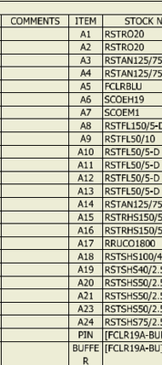

How can i use iLogic to access the 'ITEM' property from Parts List properties (as shown on screenshot)? It is not part of the BOM or the custom iProperties.

I don't know if this is a custom property (it doesn't show up in the custom iProperties tab), or if it is a built in property, but it shows up in the Parts List drop down in the Column Chooser for Parts Lists in the Style Editor, and has the following values in the parts list:

Hello @shizahkhalid,
Here an example on how to access this number from the parts list itself :
Dim pl As Inventor.PartsList = ThisApplication.CommandManager.Pick(SelectionFilterEnum.kDrawingPartsListFilter, "Pick a part list:")
For Each r As Inventor.PartsListRow In pl.PartsListRows
	MsgBox(r.Item("ITEM").Value)
Next

Thank you, this works to extract the values of ITEM from the assembly drawing parts list. I want these item values to be the labels of part drawings which i generate on another sheet. How can I refer to the parts list of the sheet with the assembly drawing?
