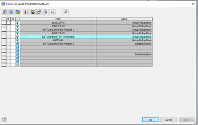

18154093
i tried and this problem
Message 4 of 9
A.Acheson
Can you show the parts list before using the group method? I am not getting the roll up error here.
Regards
Alan

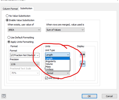

18154093
I use string "SF", because i don't know how to get unit of area in ilogic
Something's wrong ?
Message 6 of 9
A.Acheson
ft^2 would be the unit string for sq feet. I am not sure if custom units are accepted in the parts list tools. The units are not existing as standard. Maybe some more forum searching will yield a result for you.
Regards

18154093
this is not acceptable, because in the type board does not have unit of area
Message 9 of 9
A.Acheson
How about changing the unit of measurement in the document of the part to Area instead of qty. This is commonly done for sheet material. This way the qty will be added up. 2 ft^2 instead of qty 2 @1 ft^2. See tutorial on this method here
