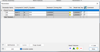

Hi again, is possible to know using the Ilogic the diameter of the hole and if it is different from the bolt or screw change the hole diameter?
I am modifying my script:
https://forums.autodesk.com/t5/inventor-ilogic-and-vb-net-forum/change-screw-dimensions-based-in-hol...
because the holes are made using Hole feature in the 3D Model.
I need to access the info of the Hole1, Hole2 and Hole3 in the assembly. This ones:
Because they aren't listed in here:
Thank you very much in advance.

To start with you will need to access the hole feature in the part. Once you declare the first hole as a hole feature you can have access to everything about that feature.
Dim oDoc As PartDocument = ThisApplication.ActiveDocument
    Dim oHoleFeature As HoleFeature =  oDoc.ComponentDefinition.Features.HoleFeatures.Item(1)
	MessageBox.Show(oHoleFeature.HoleDiameter.Value, "Hole Diameter with value in cm")
Then to access the hole feature in the assembly here is the easiest method for now just to manually select the occurrence.
	Dim oOcc As ComponentOccurrence = ThisApplication.CommandManager.Pick(
					SelectionFilterEnum.kAssemblyOccurrenceFilter,
					"Select a component")
    Dim oHoleFeature As HoleFeature =  oOcc.Definition.Features.HoleFeatures.Item(1)
Regards
Alan
