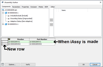

FeelGoodGirl
You are my hero! This is exactly what I'm looking for. I also managed to convert it for an Assembly.
I do have one small question. Now when I add a new line I get a #. Only in the line that already exists is a -. Do you have an idea how I can make this a # too?

FeelGoodGirl
thank you for your quick response. Unfortunately this is not the solution. Now it shows the screen with -. Close the window again and then we get this:
Ralf_Krieg
Hello
Seems like first row Member name value is not updated correct.  Can you try this manual overwrtie?
Dim oDoc As PartDocument = ThisDoc.Document
Dim oCompDef As PartComponentDefinition = oDoc.ComponentDefinition
Dim iPartFact As iPartFactory = oCompDef.CreateFactory
iPartFact.FactoryOptions.PartNumberType = FactoryOptionsPartNumberTypeEnum.kValuePartNumberType
iPartFact.FactoryOptions.PartNumberValue = ThisDoc.FileName(False) 'without extension
iPartFact.FactoryOptions.IsPartNumberIndexed = True
iPartFact.FactoryOptions.PartNumberIndexSeparator = "#"
iPartFact.FactoryOptions.PartNumberIndexInitialValue = 1
iPartFact.FactoryOptions.PartNumberIndexStepValue=1
iPartFact.FactoryOptions.PartNumberIndexDigits=2
iPartFact.FactoryOptions.MemberNameType = kPartNumberMemberNameType
iPartFact.FactoryOptions.ApplyToAllMembers
Dim oCol As iPartTableColumn = iPartFact.FileNameColumn
oCol.Item(1).Value=ThisDoc.FileName(False) & "#01"
ThisApplication.CommandManager.ControlDefinitions("AppCreateiPartCmd").Execute

FeelGoodGirl
Thank you, thank you, thank you!! It now works exactly as i would like. Thank you for your help!
