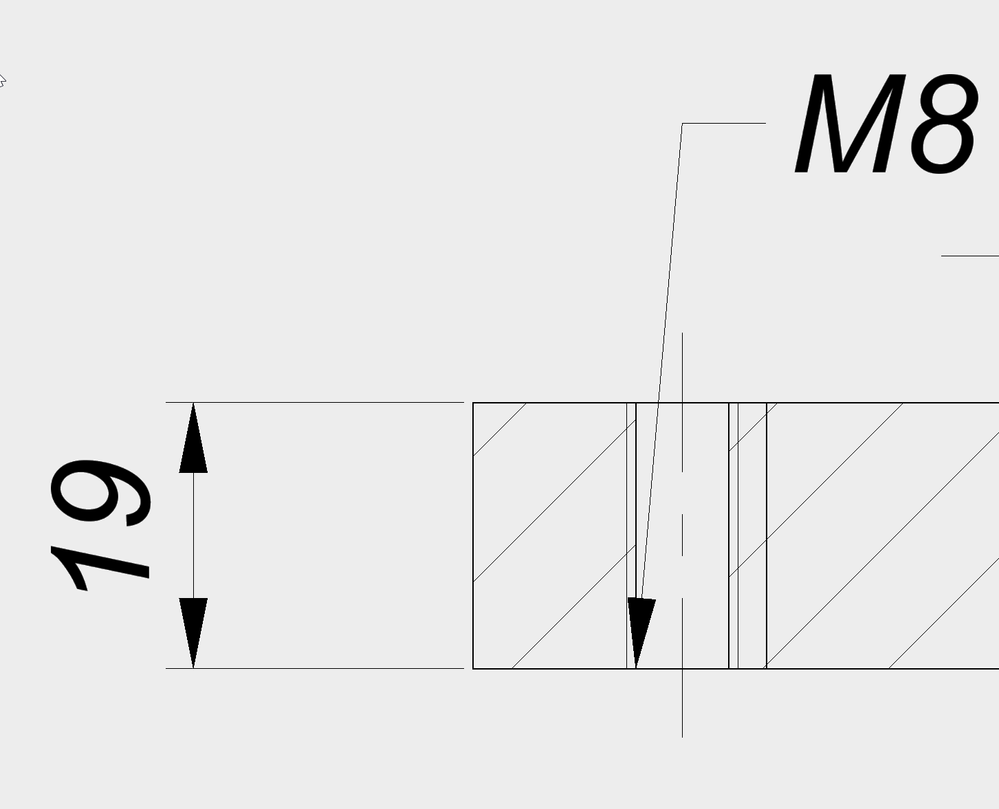

I want to get the thread dimension on the section as shown in the screenshot below.

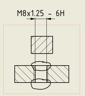

To achieve this, based on the description, I need to:
Add True as a parameter for "Linear Diameter Type", but I don't understand what I should indicate as HoleOrThreadEdge in this case? Diameter ?? which line and how do that ??

And the result of its execution is either adding a dimension as shown below:
Or (when Linear Diameter Type = true Line66) an error as in the screenshot below:
Can someone tell me what I'm doing wrong and what should I change??
