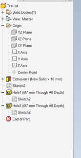

I trying to get Sketch Definition from Hole Feature.
Considering that it is the same document:
VB:
Addin c#:
As you can well see: in the second image the sketch throw me an exception that is not there in the first one.
This is Model, anyone have the same problem?

jatindevaiya08
@mirkomaga
I have created C# code for the same and it's working fine for me. See attached images.
Here is the C# code. It's console Application code. And note that Inventor application as well as Part is open when you test it.
Inventor.Application inventorApplication = (Inventor.Application)System.Runtime.InteropServices.Marshal.GetActiveObject("Inventor.Application");
PartDocument partDocument = (PartDocument)inventorApplication.ActiveDocument;
PartComponentDefinition partComponentDefinition =partDocument.ComponentDefinition;
foreach (PartFeature partfeature in partComponentDefinition.Features)
  if (partfeature.Type == ObjectTypeEnum.kHoleFeatureObject)
    HoleFeature holeFeature = (HoleFeature)partfeature;
    Console.WriteLine(holeFeature.Sketch.Name);
