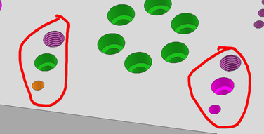

Im currently creating rule to color holes depend on hole type. Im not programmer so Im very happy with what I achieved so far. Code is mostly copy/paste from many different rules and adjusted for my needs. I need a little help.
1. These two holes are made as simple hole and clearance hole. According do API they are under one enum (kDrilledHole - 21505- Hole is drilled (no countersink or counterboring)). Is it possible to split them so I have two different colors, not one. I have not found any information.
2. These holes are made as three hole features. When you mirror them in one operation the color is taken after first selected hole. Is it possible to have proper color for each hole using one mirror operation? Of course I can mirror each hole separately to get proper color for each hole.
3. I want to make additional color for dowel pin hole. I modified clearance.xls file and added additional fastener type. I set up color as "oColor8". I need a code to recognize dowel pin hole. Hole 20 on the model (INV2023).
It should be something like this.
If kDrilledHole = 21505 and FastenerType = "dowel pin hole" then
oAsset = oColor8

Did you find the solution for number 1?
There was no eunmer to distinguish between a simple hole and a clearance hole....

Hi @robmit_arm . I optimized your code and solved your 3 problems. I hope this is what you wanted. Solution to question 3 lines 54-58.

		For Each oHoleFeature As HoleFeature In oPartDef.Features.HoleFeatures
			If oHoleFeature.Tapped <> True Then
				Dim sInfoName As String = String.Empty
				Try : sInfoName = oHoleFeature.ClearanceInfo.FastenerType : Catch : End Try
				If sInfoName.Contains("kołek stalowy DIN 6325 / DIN 7979") Then
					oHoleFeature.Appearance = oPartDoc.Assets.Item(sColor(7)) ' dowel pin hole / otwór pod kołek
				Else
					Select Case oHoleFeature.HoleType
					Case 21505 :
						If oHoleFeature.IsClearanceHole Then
							oHoleFeature.Appearance = oPartDoc.Assets.Item(sColor(6)) ' drilled / wiercona prosta, przejściowa
						Else
							oHoleFeature.Appearance = oPartDoc.Assets.Item(sColor(0)) ' drilled / wiercona prosta, przejściowa
						End If
					Case 21506 : oHoleFeature.Appearance = oPartDoc.Assets.Item(sColor(1)) ' countersunk / pogłębienie stożkowe
					Case 21507 : oHoleFeature.Appearance = oPartDoc.Assets.Item(sColor(2)) ' counterbore / pogłębienie walcowe
					Case 21508 : oHoleFeature.Appearance = oPartDoc.Assets.Item(sColor(3)) ' spotfaced / pogłębienie czołowe
					End Select
				End If

Wow. I knew my code is a mess and can be optimised. This is more than I expected. Thank you
