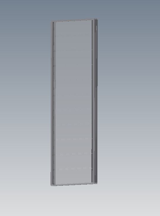

Hello
I have a problem with my Drawing. I use the rule for supressin parts and it works:
If param_val = Parameter("Mittel_Fosten_1")=0 Then
Component.IsActive("MittelFosten:1") = 1
Component.IsActive("Komponentenanordnung 2:1") = 1
Component.IsActive("Untere_Lamelle_Mittelfosten:1") = 1
Component.IsActive("Mittlere_Lamelle_Mitellfosten:1") = 1
Component.IsActive("Seite_MIR:1") = 0
Else
Component.IsActive("Seite_MIR:1") = 1
Component.IsActive("MittelFosten:1") = 0
Component.IsActive("Komponentenanordnung 2:1") = 0
Component.IsActive("Untere_Lamelle_Mittelfosten:1") = 0
Component.IsActive("Mittlere_Lamelle_Mitellfosten:1") = 0
End If
The rule runs when i change model parameters with excel.
I have a assrmbly, and within that i open a drawing to that assembly. The proble is, the model make a update, but with the drawing is something not right
285 Views
1 Reply
Reply (1)
CCarreiras
Hi!
Change the assembly, Save it... and close it.
Open the drawing,... it must be ready to update automatically, or force it by clicking "update" if you see red sparks in 2D browser.
Tip: In iLogic Assembly, avoid to have the 3D model s and drawings opened at the same time.
